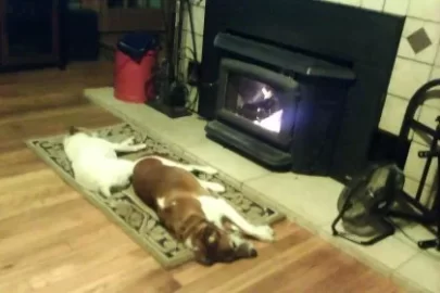

Flash back.... fan died on the PE, awaiting on a new one from PE (special order, fan discontinued a few years ago <PE installed 10 years ago> Tom Oyen at the Chimney sweep is a saint!! PE will make me a fan & motor, I just have to be patient :mad:)
Any ways... no fan IN the insert, running a small fan across the front of the extended glass front to max heat output. And my newly learned ceiling fan info!

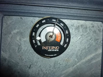

I can't see the temp coming up over 250F on the face front thermo, no matter what I do. Trust me, seasoned firewood ( I know my game at this stage ;)) and I'm looking at the PE doing it's after burn thing, with the gates of hell up top, and I'm like, WTH??? House is warm:rolleyes:, dogs are cozy, etc.
Why won't the 4 year old Rutland thermo on the upper right front of the insert read like I think it should???? looks correct to me in the firebox??? ;?
Duh, pull out back up (at this stage of the game I got back up everything ;lol) thermo (a Vulcan), and viola !!! I'm cruisng where I should be ;em
The moral of this story .... don't be a dumb sh*t, and not think :p
Murphy & Sam are very happy !

Got a pic of the Rutland thermo? Those big ones are notorious for malfunctioning; Needle comes loose for one thing.
I check my therm every year and during the year. I dont want it to read 600 and the stove is 800.
It's already in the garbage can, awaiting Mondays pick up, sorry !
Back in the day, that magnet would have stuck to the galvanized trash can and the Rutland would have haunted you forever! ;)
