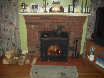

Woody I like the new pics! Seems like Woodstock really has their stoves down to a perfect cat fire heh? As you probably know, I can see the cat in the DW only by kneeling down in front of the stove and looking into the baffle. It must be nice to just look at it and see the cat lit up! I had to put the short legs on the large to get it to rear vent low enough to clear the fireplate lintel. Nice hearth BTW, we have a sort of similar fireplace, not as fancy though. In fact this house was built in the late 1940's like many of the ranch houses in this part of the state and is really "standard" in many features, fireplace included.

Nice hearth, VC! I like the variation in brick colors, and the mantel shape. My mantel is just a flat, rectangular piece of Mahogany. The brick was originally painted yellow, probably back in the 50s. We tried to scrape it off but it was just about impossible. Rather than use a stripper, my SIL who does faux painting, went over the yellow. My lousy pics don't really do it justice. I'll try to get better pics sometime...

You're doing fine VCB. That's a nice shot of your stove. The brick and hearth tile look exactly like what we used to have here.

Looks great there woody, just like a Woodstock ad. It even has the signature keystone right over the stove.
Is that what that rock is called? That worked out well, didn't it? :lol:

I swapped the first hearth pic on page 1. I think this one is a little better; Clearer, more fire, and you can see my sittin' log a little better. :)
