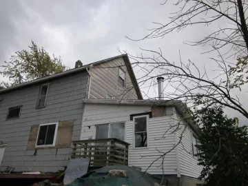

The family room is a one story addition, 15.5' x 25' with its own crawl space, exposed to the wind on the east, west, and north sides (catching all of the prevailing winds.) The rest of the house is a 2 story with a walk up attic on a very windy hill. The stovepipe for the Englander goes straight through the ceiling at the lowest part of the roof of the addition. The triple wall chimney is installed to spec's, high enough to account for the rise at 10', etc.
When we fired up the stove, we had terrible back-draft problems. The whole house smelled like smoke. Yuck! :p Even with the damper all the way open, we still had difficulty getting a good burn. We still have some windows in the second story to replace and some tightening up of the attic to be done, so it's possible this is adding to our issues, as well.

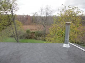

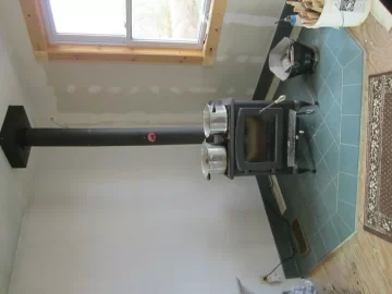

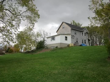

Here are some pictures of our setup, if that helps. (This place is a work in progress.)
First three pictures are of the north side.

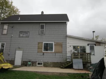

Fourth picture is of the NW corner.
Fifth is the SW corner, taken from near the bottom of the hill.

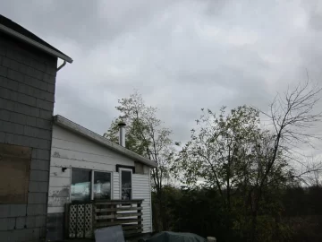

6th is the chimney from one of the upstairs windows.
Last is an inside shot.

You need to increase your chimney height. The manual calls for at least 15 ft; it looks like you have barely 10'. Double-wall stovepipe inside will also help keeping the flue gases hot enough for proper draft.

Not to be a bother, but what is under the tiles of the hearth? The 30NC needs thermal protection with a r-value of at least 1.5. Most of the time that means a raised hearth to get enough insulating layers under it.
Hmm. One would think that location would work well with the prevailing winds coming from the west, but there just might be a swirling effect due to the higher roof. I'd definitely try at least one more 3' section. I know it may not be aesthetically pleasing, especially since you'll need a roof brace kit, but it may just mitigate your back-puffing issues...
Do we need to go even more than 3' of additional pipe?
I just measured and we have 5.5' from the stove top to the ceiling. I checked our order for the rest of the pipe and saw that we ordered a 6" through the ceiling kit and 2 36" triple wall pipes. So, it looks like we're a little shy of 15' right now. ;em
There's a 1" layer of cement board under the tile of the hearth. Not sure if the stove pipe is single or double wall, I'll have to check with DH on that.
Is there a special wind cap that you'd recommend, or will the extra chimney pipe take care of it?

First, the hearth is inadequate. Even if you have Durock next gen in there it would give you only about 0.8 in r-value with the tile. (broken link removed) Please refrain from using the stove until you have addressed that issue.
You have a bit more pipe than I estimated but you are still short. Just as a test you could add 3 ft of stovepipe on top and see if you get a better burn. If that is the case, get some real chimney pipe and a bracing kit and extend the chimney.
We've had some bad weather conditions in our area for wood stoves. You may or may not find that waiting a few days will make a big difference. Personally, I'd wait, make sure your wood is very dry and then see what happens. If still a problem, add some chimney. Problem is that chimney costs a lot and if it doesn't solve your problem, you can't take it back once used - although I've seen enough used stuff on the store shelves lately.
Yeah, looks like a strong wind from the NW could be a problem. I'm no draft expert but I'm guessing additional chimney might be a big improvement. Anything over 5' total will require bracing. As suggested, you can test weather it will work with some cheap snap-together stove pipe from the farm store to see weather it's worth investing in chimney. Still unanswered are the questions of weather conditions when you experienced low draft. Windy? Not very cold out? And what kind of wood, and how long has it been split and stacked? Since you were getting good results before, I'm gonna assume your fuel is at least passable...
These caps make a big difference in windy areas. I installed one when I lived on a prairie that had frequent wind. It solved my down draft issues!
