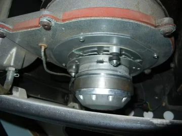

Almost a must have for the Ecoteck with its hard to access rear exchanger area. Take off the pressure hose from exhaust blower. Keep the door open. Will keep the stove lighting well for the season without taking off rear access ports off and cleaning if used frequently.
Good info. Where exactly is the pressure hose? Thanks.
You can see it on the far left side outboard of the exhaust fan. While your in the area take out the temp probe and wipe it off too.

Some stoves have the pressure or vacuum hose at the stoves exhaust fan exit and need to be disconnected to eliminate possible damage. The door open won't do.
