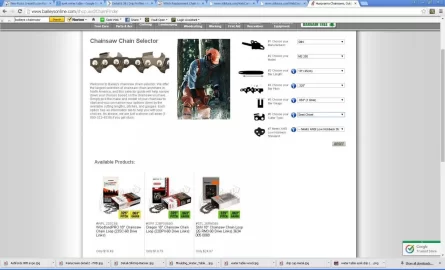

Get us the numbers off your bar, to confirm gauge. Either way, you should be able to pick up 18" low-kickback Micro chain for under $20... probably under $18.
edit: neb'mind... just found the manual. Yes, it's .063. Bailey's has Woodland at $16.50, Oregon at $19.

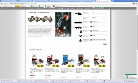

Here's the full chisel and semi chisel options. All low-kickback.
Me? I'd head to my local saw shop where I'd probably pay under $18 for the first two, and get the third free. There, it's whatever brand they have on the spool, that meets your spec. They stock Carlton, Oregon, Husqvarna, and Stihl, interchangeably. I assume you'll have a similar shop in your neck of the woods.
