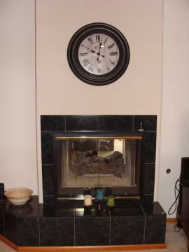

Any possibility that a stand alone stove would work in that place? Some are quite nice looking from all angles. Pics of the current setup would help.

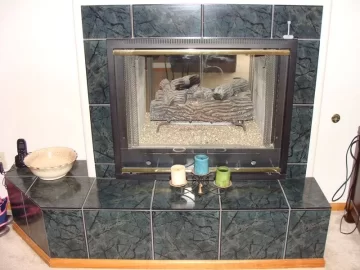

1. I have yet to see anyone burning in a double sided fireplace get heat from it.
2. All the units I have seen are Zero Clearance and would require ripping out the existing and starting new
3. Some single sided ZC units can be adapted to your central air ducts, none that I am aware of for hot water
Get us some pictures of the setup, that is a whole lot of sq to try and heat with a single source of wood heat.

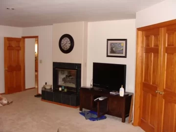

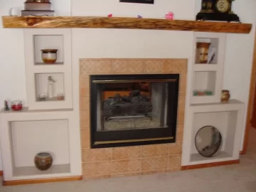

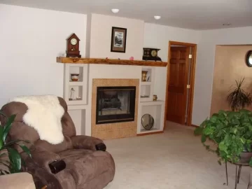

pics attached - hopefull you can see them.

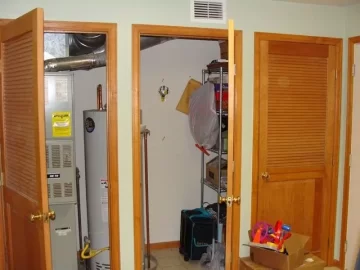

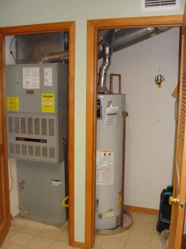

@begreen - sorry, I did forget to answer that in my last reply. The primary heating unit (forced air propane) is in a utility room located 3/4 of the way to one end of the house - opposite end from bedrooms, unfortunately. Your idea is very intriguing. I had seen some "homemade" versions of that - are there commercial products along those lines? There is plenty of room in the utility area, and running stovepipe from there probably wouldn't be too bad. There is no basement, but a "tall" crawlspace throughout (4-5').

The height of the utility area presents a clearances challenge. There are some good, clean burning and efficient wood furnaces made, but it sounds like this would not be practical due to clearance requirements for the furnace, supply duct and flue. Also, you will be feeding this furnace a lot of wood over the winter, so good, easy access is important. Hauling wood around while hunched over in a crawlspace doesn't sound ideal.

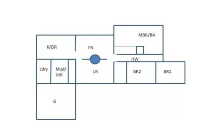

What is the size of the house? Ceiling heights? If possible can you post a simple floor plan sketch?

Good morning! I put together a rough floor plan - can't find the "real" one. (Sorry - I loaded it last so it's below all the pics.) This is not to scale, but not far off - I have a fair "eye-tractor"! The blue circle is the location of the existing fireplace. I also took pics of the existing fireplace with more context, and a couple of the utility closet. The closet shows as the narrow unlabeled room in the "Mud/Util" space. The closet is over 50% empty (discounting "junk" shelf) - plenty of room for "something", though the depth is only about 3', so it might be too shallow. I would even consider pushing the wall out, if that "something" made it worthwhile - it's just in a mud room that is oversized anyway. Ceiling heights throughout are 8.5'.
At this point, I'm semi-giving up on replacing the existing fireplace, since most of the responses have been fairly negative on that idea. Seems the most efficient might be to put a wood-burner in the utility area and duct it into existing system. There is existing exhaust pipe (obviously), and it's just off the garage, so access isn't bad. Woodpile could even be in garage - there is plenty of space.

Can a unit like the Drolet Tundra go into the Laundry room with a class A chimney out the side and up? Seems like that would be the best and move the Laundry to the mud room? I would put a door for access to garage to store some wood in.
You will need new exhaust venting rated for wood burning appliances.
The closet will probably be too small for a woodfurnace plus its clearance requirements. Here would be another example of a possible unit: (broken link removed)
Check page 15 to see how much room you will need.
If you want to do a wood add on furnace, it's going to take a wood furnace with very close clearances to fit in this location. I recently saw a unit on the market from Napoleon that might work. I don't know a lot about this furnace, but it does answer the clearance issue - it's model is HMF100. Here's some info and the installation manual.
