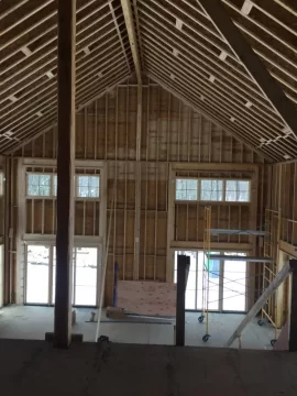

hi , I’m currently building a weekend home . The great room Where the stove is going, is 35’x 35’and 34’ high in the center.
I like the alderlea t6 because it has an unobstructed view . The jotul 600 is nice looking though. Although I like the jotul 500 clear glass model , but I think it may be a little small for this area.
I’m a little scared of getting catalytic because of reviews I’ve read of Lopi and VC catalytic models. (Ironic , because a picture of Vermont castings Defiant is what inspired this whole project. )
The stove is obviously not supposed to be the main source of heat ,but I would definitely like it to do something.
Any ideas ?
Thanks
JS

Can you post more pictures from different angles? Also a sketch of the floor plan.

Is the staircase permanent in the first pic or for construction purposes? Can you take a pic looking back at loft? A centrally located stove will heat the whole place better.
Looks like a perfect candidate for hydronic radiant floor heat!
