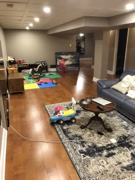

I’m in southern Ontario. We have small bungalow (920 sq feet main floor and 920 sq feet finished basement. We want a stove in our basement which would be only a few feet from out main tv area. I’ve attached a pic.
The house is very efficient as it is. New efficient furnace and good insulation.
We just love wood heat and the ambiance.
I’m just worried to get burned out sitting so close to stove.

A small stove would probably suffice, especially if the goal is ambiance and not 24/7 heating. A smaller Jotul F100 or F3CB would be better in this case. Is there a nearby open stairwell for the heat to convect up to the main floor?

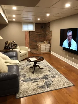

Hmmm. Makes sense. I’m not sure adding a grate is possible as it’s a drop ceiling in the basement. I’d have to explore that idea...
Here is a pic looking toward the stairs from where the stove would be.
The stairs are at the far end of the pic going up back towards the living space.
The plan is to use it when we are home. (We are home a lot). Love the smell and feel, but we do not need long overnight burns. Not a concern.
Again, we have an efficient home and furnace. House warms up very quickly.
Just want to enjoy the fire and if it takes over the work of the furnace in the process, it’s a bonus.
There is a window there behind where the stove would be so that could help control overheating as well??

Based on the insulation and use it sounds like you will be fine with a smaller stove of 1.5cu ft or less.
