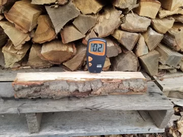

A lot of people are saying oak takes 2-3 years to season. I just checked my white&chesnut oak stash and two random splits measured at 20%. CSS May 2017. It was cross stacked, two layers deep, top covered, on pallets, in the woods. Measuring at 31% in Aug 2017. Very surprised.
Are people normally aiming for 14-16% or have very large splits? These are on the smaller side, 2x3" avg. The ones I split were ~4x4 triangle. Curious what was the success factor...

I see you did this outside, what was the temperature?

It was about 45°F. What temp does the MC start to get affected?

I would say you could see a difference of up to 8% difference with it not being at room temperature. Which would make the season time less quickly than thought. If one of those splits would be brought inside to warm, you would get a more true test.
Most of the consumer grade (under $100 retail) moisture meters are calibrated for Douglas Fir at +70dF.
With soft woods like pines and spruces at +55dF you can add "1" to whatever % you see with the meter and be close enough to run your stove safely.
There is probably a correction factor for hardwoods like oak to consider as well. I dunno the temp correction factor for +45dF.
Overall it sounds like you are dong great, unless the correction factor ends up being "plus 15". Something like "plus 7" would put you mid-pack-ish, but still you get kudos for working at it and checking with a moisture meter.

I'll try bringing one inside too. From prior posts, I heard the Dr Meter without wood setting is set to #3, which is for general hardwood, I guess something like soft maple or doug fir. Some people didn't see a difference between setting #3 and #4 on their new model.

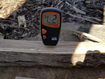

Well a little update. I split another piece, a bit smaller, and it was at 27%! More what I was expecting. So 2yr it is!
I brought it inside for 3hr and measured 27-28% max, 24% at the ends. It was 35°F outside.
This was a Quercus Alba white oak, so either there is large seasoning difference between chestnut and white oak or this one is underneath a stream on the tarp...
