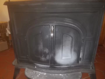

The right side front door, the one with the handle, has a large round white spot on it. Any ideas? I tried Google, but it assumed I meant the glass and not the exterior. Is it from touching it with my bare hand? This seems to have happened in the last hour or so. There's also a bit of discoloration on the left hand front door, and a bit around the handle on the load door.
  • [Hearth.com] White spot on front door 1975 Defiant
That looks like the stove is overfiring in that area causing the finish to go chalky. When were the door gaskets last replaced?
Air leak causing hot spots. Black stove paint will lighten up and turn white at higher temperatures.

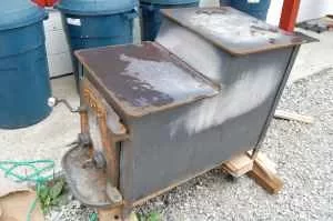

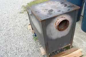

Below is an example of a very hot stove. These are steel plate and no damage was done. Normal for black stove pipe that reaches those temps as well.
[Hearth.com] White spot on front door 1975 Defiant [Hearth.com] White spot on front door 1975 Defiant
Any leak at gaskets, seams or pipe connections lets air IN, not smoke out, since the chimney flue causes a low pressure area in chimney, pipe and stove. Oxygen leaking in burns hotter in spots around leak. Your paint may be getting old and more susceptible to loosing the color with added heat. Higher quality paints also hold color longer at higher temps.
I don't know when the gaskets were done last, but I have a replacement set. This stove really just needs to make it through the winter. Ideally we are replacing the stove before next winter. I did check all the doors with an incense stick to try and find leaks, and didn't see any. I do also think there was a split against the door right there.
