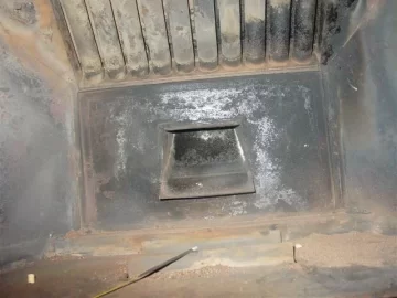

I'll try to post a photo.
Please do I don't have a lot of experience with the Plus. That must be one of the major differences between it and the ADVII-T
Look and wonder...
Witness the creosote on the right.
