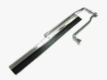

Several singlearm handoperated wipers are available on the market. In marine stores they have the Sea Dog Manual Windshield Wiper:
http://www.sea-dog.com/groups/1887-manual-windshield-wiper

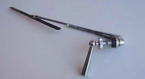

And in a store for vintage autoparts they have this handoperated wiper assembly used in Ford cars from 1928-31:
(broken link removed to http://lbcunited.com/earlyford2/product_info.php/cPath/96_291/products_id/3345?osCsid=af964f0283c5d308faef78073a913f0e)
[Hearth.com] Whitfield upgraded burn grate
The rubber parts must be replaced with a heatresistant material. The Lytherm gasket sheets should be perfect for this if it is cut in the right sizes. The two rubber washers/gaskets sealing the wiper hub could also be replaced with some of similar size made of Lytherm. Thermo-silicone will be a perfect way to fix the Lytherm wiper-strip in the metal rail.
Imagine how wonderful it would be to have a perfectly transparent window just by operating the wiper now and then? And another benefit: The air wash slots could be blocked permanently, because they won't be needed anymore. This will also improve the draft.
