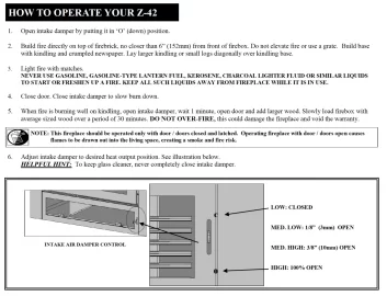

The Kozy Z42 has an EPA listing of 3.3gm/hr. Why do you think it will be phased out at the end of the year? It is well under the 4.5 gm WA state emissions requirement. That means it should pass EPA step 1 requirements as well.
EPA’s final rule updates existing emission limits for adjustable burn-rate stoves in two steps over a five-year period:
  • Step 1: The rule becomes effective 60 days after it is published in the Federal Register. At that time, PM emissions limits will be identical to those currently required by the State of Washington for noncatalytic stoves. Most adjustable-rate woodstoves manufactured and sold in the U.S. today already meet the Washington state emission standards; these stoves will be deemed automatically certified under the final rule.
    • To ease the transition to cleaner stoves, EPA’s final rule will allow woodstove retailers to sell existing inventory until December 31, 2015. After that date, any new woodstoves sold at retail in the U.S. must meet the Step 1 emissions limit.
  • Step 2: Five years after the effective date of the rule, woodstoves will have to meet stronger emissions limits (see table below).
I'm confused by the statement that the Kozy Z42 has no adjustable air control. What is this?

Of course it has an adjustable air intake lever! It's on the right side below the door.
Yes, I don't know where that statement was coming from.
Correct me if I am wrong but I do not think the Z42 has any adjustable burn rate controls
or dampers for intake or chimney etc. You can fill it full of wood but it is going to burn
up pretty fast if you cannot slow it down.

Thank you for correcting me about the adjustability of the air intake on the Z42.
I could not see any levers in the brochure and there was no mention in the brochure
so I thought that was how they got the stove to meet EPA regs. I am a 14
year happy user of the Kozy 231ZC that is 11 inches taller with the same size
firebox. That extra 11 inches up top is where they house the secondary burn chamber
and I would really like to know how Kozy co. managed to keep and improve on
secondary burning with the shorter Z42 as it seems to me they drastically reduced
the secondary chamber size. Kudos to Kozy as I did not know they met
the new EPA regs with an impressive pollution rating.
