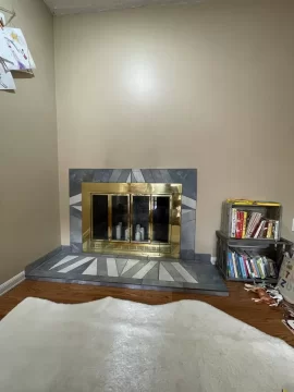

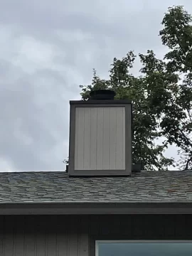

I am preparing to tear out an old defunct prefab and build an alcove. It sits in the middle of the home, and given the dimensions of the wall I should be able to get about 29” of depth and probably 58” width for the alcove.
Just trying to collect some experience from anyone who has done a similar project.
What can I expect to find when I start ripping open the wall and pulling the pre-fab out? Any advice prior to starting that might be helpful?
Attached are a couple pics of my prefab and chase, and some pics of the direction I want to go with it.

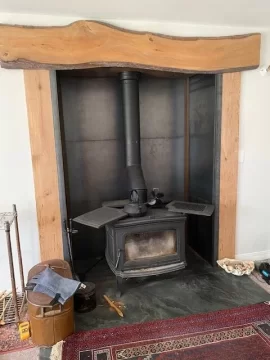

I assisted friends building one last year that was in place of a ZC fireplace. If the ZC was installed correctly you will find a framed box, that enclosed the fireplace with a header at about chest level. With the header removed, it is not unlike a closet.
This is not the greatest shot, the stove was in service at the time. They lined the cavity with sheet steel on spacers with a 1" air gap behind.

I really like the finish of the one you did here.
Did you hang the sheet steel? This allowed for reduction of clearances by 30% or so?

I didn't do the work, just provided technical support in stove selection, clearance requirements, etc. Clearance reductions will only drop down to 12" unless the mfg. has specified lower clearance in the stove's documentation. Peace of mind was important to this family so they exceeded specs with their installation.
The header over the ZC is just supporting the studs above it and maybe flat-faced to support a mantel.

So true. For example, our neighbors found that the exterior chase was completely uninsulated and had no fire stop at the second floor level.

Any chance when I open it up I’ll find a configuration that wouldn’t permit me to build an alcove?
I can’t imagine that there would be a load-bearing design around a pre-fab insert that couldn’t be reconfigured, but then again it’s a 1970’s house...

Not really it's all just framing I don't see how it could prevent you from making an alcove.
