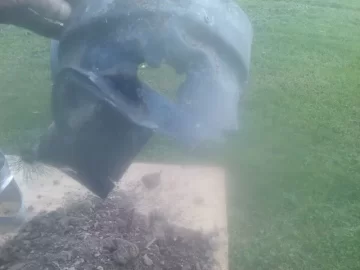

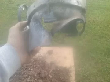

All of this being said no matter what liner you use if you abuse it you can destroy anything here is what was left of the top of a tee we pulled out and replaced today that was put in in 2006 and yes they had many chimney fires
