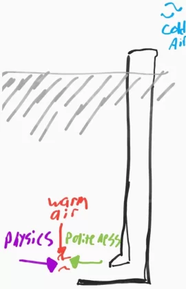

Maybe in Canada, the warm air that you worked so hard to warm up is just a little too polite to flee the house via the chimney.
[Hearth.com] why are block off plates not needed in Canada?
South of the border, the politeness levels degrade and physics is free to push the warm air out of the house.
