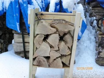

Production howto:
Buck to 16" rounds. Split rounds to max width ~3.5". Buzz those splits on cheapie HF tablesaw. (Minimizes loss to chips.)
Of course, cutting & splitting smaller speeds drying once seasoning is done.

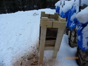

DaFattKidd here is a link then go to post number 23.
https://www.hearth.com/talk/threads/60241/
zap
Zap,
That's awesome! I was thinking about it last night and I had a similar idea, but yours seems to be a perfected version of my half-assed idea. Thanks.

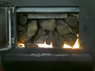

DFK here are a few pictures of it loaded up.
zap
  • [Hearth.com] Why I buck it 14.75!

x100. Not only can you get more in but it is also easier. I replaced 3 panes of $100 glass on my old EW stove but I don't think any log has even touched the glass on the new one even though it gets loaded this full every time.
Now, it the goal is ambiance instead of heat, I might think differently. Of course, if the goal was ambiance, I wouldn't have bought the stove I did.
