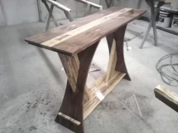

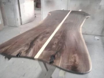

2-3/4 inch by 32 inch wide Black Walnut. Same tree as this slab.
Jay I'll say it again,that is one of the most beautiful pieces of Black Walnut I've ever seen in 30+ years of woodworking.

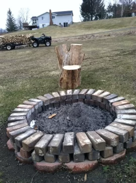

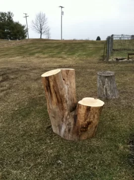

I do have a 4' long 1/2 log of maple I noodled/milled with my saw that has been barkless and drying for a couple years and I am planning to forge some iron legs for it and using it as a bench around the fire pit. I will have to take pics so it is believable but in the mean time here is the recliner I made from a very large ash crotch this winter. Kind of just happened as I cut up the tree and stood this monster up. I looked at it for a bit and sat down - dog gone thing is perfect so it go loaded on the trailer and stood up next to the pit. Worst case, there is at lest 3 nights worth of heat in the bugger!!

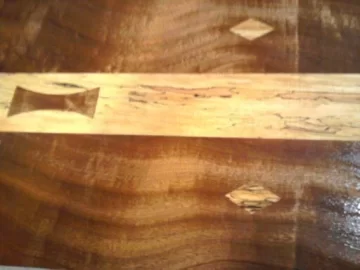

These bow ties really show off craftsman ship: Better have lots of practice before doing this on a sanded slab.
Heres one of my cousin joint work. He does this for a living. One more just to show off his skill set.[Hearth.com] Wider Slab for a Coffee Table

Nice work, I appreciate stuff like that. Looks really clean, like a router inlay set up. I have some wood projects underway and I may have to throw some on them for looks.

Inlays are an awesome touch. I just not that good yet but I keep trying.
I free hand cut them on my band saw. I then use a fine tip pencil to trace them on the board. I use a small router bit to remove most of the material and chisel out the rest just inside the pencil marks. I sand the dutchman edges until snug in the hole. Glue and sand.
