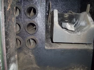

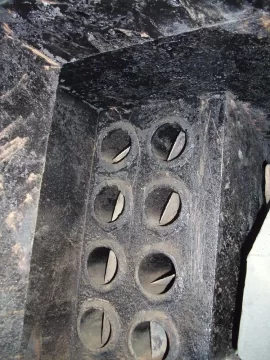

    So I posted a picture a week or two ago of my firebox after a bunch of tar had condensed onto it (still haven't figured out why ... wondering if maybe my door seal needs replacing). Anyway, much to my dismay, that hardened into a glaze-like creosote. I tried to break it down with this stuff:
    http://www.amazon.com/Rutland-98-Lbs-Creosote-Remover/dp/B00120NNCY
    but I just don't seem to be able to get it all. There's still a jet-black sheen over my entire firebox (although only 1mm thick, at most). I attached a couple of pics - you can see that while scraping I managed to get a few spots of bare metal to come through, so it's not thick at all. Here's my question, though: do I need to worry about this stuff, or can I just leave it be?

    What make boiler is this? Is it shown disassembled in these photos?

    I think your getting carried away. The first cold night will burn it all away. Maybe I'll take a pic of mine. Today is day 4 and I haven't opened the door yet. I did check the hopper yesterday and was happy with the amont left but it has been in the thirties and forties.

    It's a CB Maxim M175. It is assembled in the photos.

    OK. I thought that was probably the case, but the manual has such ominous sounding warnings about how creosote will trap moisture and rot the firebox that it just made me a little paranoid.

    Another thing to consider a layer of creasote, or any build up inside the wall of the boiler will start to reduce the efficiency. experts claim a few thousands of an inch of buuild up inside HXers really starts to make a big difference in heat exchange.
    Possibly some of it will burn off with a long hot fire.

    That powder is to burn in a fire, if anything the powder that puffs into the flue would be what you need. It will absorb the moisture from the glaze, neutralize and should turn anything into a residue that should come off easily. I believe it's called third stage remover. More than likely what's there should burn off once a good hot fire is produced.
