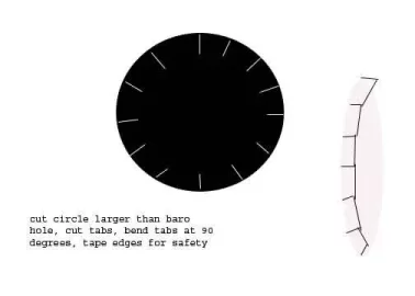

I think it's hard not to smolder wood during this season. One thing I am trying is I made a cover from sheet metal for my baro, which I am using just on 40 degree or so nights. I figure I might burn a little more wood, but make a little less creosote. When the temps go down, I will just pop the baro cover it off.

Hi Mike, I see were burning the same furnace. How is that plate working?
I was thinking about removing the baro draft totally but I like your idea better. Mind if I borrow it?

The cover for the baro works great on these kind of days. I just took a piece of sheet metal, cut it round about 1.5" larger than baro outside diameter, then made a bunch of cuts every 1 " or so all the way around the circle, then bent those tabs all 90 degrees. Then I used furnace tape to tape over all the edges so I wouldn't cut myself. Tried to draw a diagram and attach. With this set up I can put it on and take it off easily, tabs bend a little to help hold it on.
