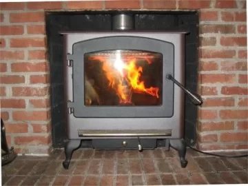

I have been facing the same issue about my fire place modification to accept a wood stove. Even though I modify the fire place the insurance company could call the install an insert and not pay. I found out that the Kuma Ashwood is certified as an insert, free standing, and alcove approved so my install will not be questioned on this issue and my warranty intact. This stove may fit your fire place, with the cast iron legs, it measures 28" tall.
What I have found is, if the stove sits in the firebox in anyway it needs to be certified as an insert.
