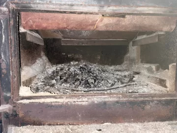

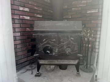

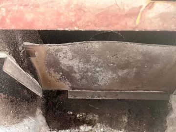

Will you purchase this stove, are there any red flags to look for ?? Beside it missing all the firebricks.

Is it not missing all it's firebrick? To me that's like buying a car that has no oil showing on the dipstick.
However, if the price is right, I guess you would need to look closer for cracks. Does that have secondary combustion?

No it doesn’t have secondary combustion
Its an older Timberline steel stove, not bad for its time period. That upper baffle looks pretty beat, and running it without bricks (if they did) is not a good thing. I'd pass on it, there are too many better stoves to use out there, IMO.

Depends on the price and what you want it for. To heat a shop for $200 to $300 sure. To heat my house or for any more than that nope
Reactions: Itslay90
I think I can get a lil more then that, probably $250
For a Timberline with a crappy auto draft thats probably broken? Cleaned up painted new brick etc your looking at $400 tops in mostarkets for that stove so you might make $250. For 8 to 10 hours total to do it well? Not worth it to me. Especially when you could make that just picking it up and selling it as is.
