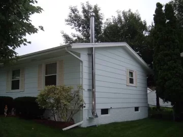

The furnace and wood stove each have their own separate chimney. The chimney for the wood stove is a through-the-wall type (metal pre-fab) and extends up the outside wall and through the edge of the roof. The height above the roof (at the point where it goes through the roof) is just over 4 feet (the total chimney length is 15 feet). The wood stove chimney is roughly 7 feet from the roof peak and extends above that peak by around 2 feet. The furnace chimney goes through the roof at the center of the house and is 20 feet from the wood stove chimney.

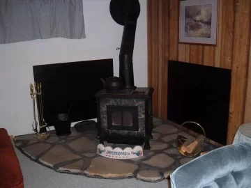

For some reason I couldn't get this pic attached with last. This is the inside view. I have a window (basement type) near the stove. If I were to use an air supply ventilator as suggested, could I remove a pane of glass from the window and mount it there? (drilling another hole through concrete doesn't sound like fun - the chimney already goes through the concrete). Also, someone mentioned a chimney fan to induce draft - do you think it would work with this installation? Thanks again for the help.

Oh, it's an outside metal chimney. That could be the problem too. Are you going to build an insulated chase around it in the future? That would help. Those chimneys get real cold since their exposed to the cold air. It will take some time for it to heat up and maintain a draft.

Window would probably work but look wierd. When I installed my ventilator, I drilled through the header just above the sill plate in a different room, and used dryer vent tube to run down low near the stove. But maybe you can install it near your furnace. Anywhere in your basement probably would help.

Chimney looks good and should work good. I concur with everyone else that it is a negative pressure problem.

One other question have is in regard to the indoor chimney pipe. This is double insulated pipe and it has slots in it (Security brand pipe). These slots are around the ends of each pipe section (you can see the inner pipe through these slots). In the winter when a down draft is going, I can feel cold air blowing out into the living space through these slots. I have often wondered if these are contributing to the problem. Would changing to a solid double insulated pipe be worth it?
First I would like to say that a very nice looking install with your wood stove AND I love to see all that GOLD shimmering steel from the out side ( Ops , I meant STAINLESS STEEL = $$$ , ha. ) In my opinion only i think you have a lot of little different issues . The replies have stated them already .......... boxing in your chimney to help keep it warm and the cold and wind off of it even tho the stainless steel looks nice. All that stainless steel is going to draw a lot of cold onto it and make for a harder down draft. ( i hope the pipe is not on the north side of the house ) As we know , cold air is heavier than warm air and when the pipe gets cold its going to drop that cold air right down the pipe. The chimney needs to stay warm = box it in. I think elkimmeg stated your other options/issues with combustion air and some options for your basement . (post #10 ) The CO2 and smoke alarms are also a good suggestion. ALSO to help out with draft on starting a fire ( after you look into the other issues first ) you can always take a ceramic 1500 watt heater and put it on top of your stove aimed at the pipe (or in your stove ) to heat up your pipe and to get the draft going in the right direction before you build a new fresh fire . Be safe .

Your situation with an outside metal chimney is a common situation. There are two type of class A chimnies the one you have using an air space between the liner and outer jacket and then more espensive the solid filled with insulation. In your case the soild insulated one reacts better at holding in the heat and drafts better. Roo and others mentioned another solution box in your chimney in an insulated chase or opt for soild pack clas A chimney. I agree that looks like a good install. We had a post last week where enhanced kindling startups might help slove your problems. You may use Fat sticks and build your fire adding bigger and bigger kindling to small splits to get it going. Pre heat options will also help. How dry is your wood?
