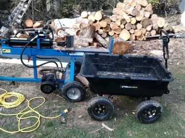

I have a ramsplitter HV-16 electric. It is pretty powerful, and will go through most of what I have thrown at it. I had some 40" rounds of white oak that it just wouldn't do. I split them in half with wedges, and then it would bust them. Other than that, it has gone through everything. I think the 20 ton model would have done the white oak.
[Hearth.com] Wondering about noise level of wood splittters.
I like it because my 8 year old can work with me (running the controls) and still easily hear my instructions. MUCH more productive than doing it alone, and lots of fun for a boy who wants to be like dad. I let him position the smaller rounds that I split once down the middle while I run the controls and he loves it.
They make both a 16 and a 20 ton electric. Be careful that you use the properly sized drop cord or it will burn up your motor. I got mine used for a great price.
It is not for everyone, but I really like being able to hear and instruct my son while splitting.

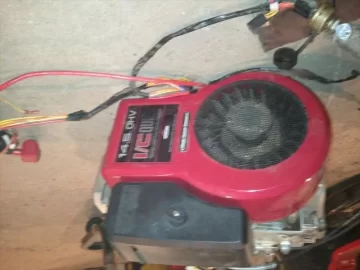

The last splitter I built got a briggs 14.5hp OHV "quiet" motor strapped to it. Pretty impressive. At half throttle you can stand next to it and have a fairly normal conversation. (sorry for the blurry pic).
