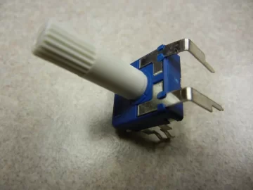

The pot switch may have developed a bad spot. Easy project to replace [Hearth.com] Wont start in Room Temp. But does in Stove temp Is a known issue

Also I have a few of those Pot Switches. Bought them off EBay a couple of years ago. Was told they may go. After it fired up by tweeking the temp dial, I have been heading in that direction. Just have to practice my soldering again I guess.

Good thought, but the wife tried starting it this morning. Room temp was only 63. Dial on stove set at around 72-75. I tweaked it from just below th e5 to just on the 5 when it started. Kind of thinking Bioburner is on it with the pot switch.

Could be your room temp sensing probe is starting to act up and sensing an inaccurate temp in the room. If it works fine in Stove Temp mode( temp sensor not in play) and you are able to adjust the temp knob 1-7 with no issues, then it's not that pot. Check your room sensing probe and make sure it hasn't fallen from where you normally have it to a different location (like near the cold floor)
talked to dealer. Almost certain the Pod is wearing. Another sign is if I turn the dial down to 1, it should shut off blower and flame , to scrape the Pot. This doesn't. If I fiddle it a little then do it It sometimes does.
