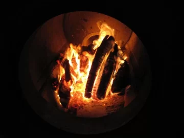

A niced size Garn in the barn would work good for you. And there is no need to be worried about gassers because of dry wood - that's sort of looking at it backwards. With a gasser & dry wood, you'll be burning way less wood so will be way ahead of the game once you get a couple years worth of wood ahead. And I don't burn wood that's any drier in mine that I used to with my old smoker - you just can't burn wet or green stuff. A year or two (depending on species) after it's split & stacked & it's good. I'm burning right now white birch that was still alive & growing well 8 months ago - I split it pretty small though to get it there.
1 year split, stacked, covered on top looks like this in a Garn - [Hearth.com] Wood boiler purchase

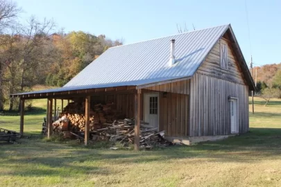

Welcome fellow Superglide rider! For the price I've been impressed with our BioMass. Certainly many happy EKO users here and Boilerman has good experience with Attack. Three excellent, cost effective east European manufactured gassers. A visit to New Horizon will let you see them all in one place. I love our boiler in our barn. We lose some efficiency, but gain in the laziness of dealing with my messiness. You're first cut list looks pretty good. My barn's not as nice as GG's but looks like it belongs in the hills of Tennessee. You can see how close our wood storage is to where the boiler is set in the corner. Enjoy the research and take your time, you'll spend a bunch of time with your decision.
