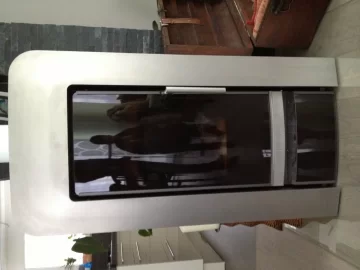

Buderus makes a wood boiler that is also a stove. My buddy in Germany has one that he uses to heat the floor and to throw heat into the room. They have this brand here but the model may be another story. I have uploaded a pic.. [Hearth.com] Wood boiler stove
