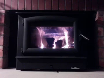

Lopi is something to look at, they were a bit more expensive but I was told it would be too much stove for the 550 I was heating. You will definitely save money installing your own, it is quite easy, took me and a friend less then 4 hours till we had a fire going and that was with a 6"ss flex that barely fit down the chimney. Sounds like money is no problem so I say get big and get what looks best to you, mine has a big fire viewing area and looks awesome, so get the biggest glass surface area without any decoration in between to hinder the fire view. I hope this helps, here's a pic of my non cat.....gl

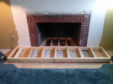

OK, it's been a few months and progress has slowly been made. I did end up buying the Buck 74. I've been burning for 4 days and, so far, have been very pleased with it. I'm amazed at how much heat I get out of it only burning a few logs, without having to continuously stoke and pack the firebox like I did with my old Buck insert. I'm attaching photos of my progress so far.
I tore out the old hearth and framed for the new one...

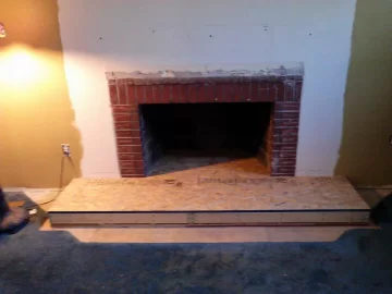

I then sheeted with 3/4" OSB...

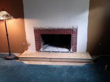

Inside the opening I poured a wire reinforced 2 1/4" thick high tensile strength concrete slab...

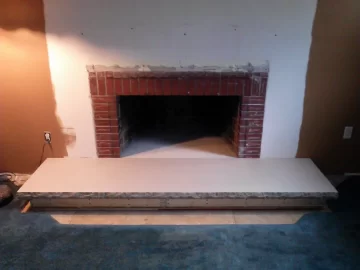

After curing I then installed a 2' x 8' x 2 1/4" rock faced limestone slab for my hearth...

I would appreciate hearing any and all comments, suggestions, criticisms on what I've done so far.
The final look is going to be great. However, I'm concerned about stove base and the stone hearth resting directly on wood. In the least I would have put a layer or two of cement board like Durock NexGen down for insulation protection. The stove being off its pedestal is going to project a lot of heat in front and underneath. That is going to warm up the stone a lot. Hopefully this will dissipate over the block, but I am concerned that the stone will act as a conductor and not an insulator when there is a strong 24/7 burns going. I have even greater concerns for inside the fireplace directly under the stove. There I would have used only metal studs and cement board under the poured cement floor.
Call Buck and ask what is the hearth insulation protection under and in front of the stove that they recommend when the stove is off the pedestal. The manual doesn't cover this case. I suspect they are only thinking of installations with a full masonry fireplace floor and hearth.
