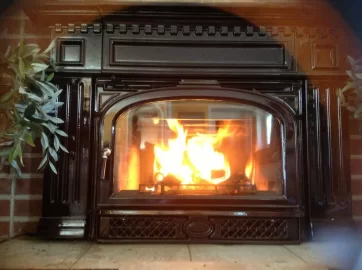

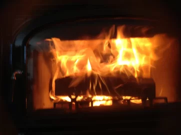

Well I have a medium insert that I am quite happy with, so for 1800 sqft, I would recommend a large insert
Lopi is something to look at, they were a bit more expensive but I was told it would be too much stove for the 550 I was heating. You will definitely save money installing your own, it is quite easy, took me and a friend less then 4 hours till we had a fire going and that was with a 6"ss flex that barely fit down the chimney. Sounds like money is no problem so I say get big and get what looks best to you, mine has a big fire viewing area and looks awesome, so get the biggest glass surface area without any decoration in between to hinder the fire view. I hope this helps, here's a pic of my non cat.....gl
