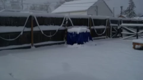

Just had to cancel out three different aspects of this job--installment, closing the porch up and electrician---terrible weather coming and it is off and on all week with snow and arctic air that's coming. I have my left over lumber stored like Nate in a temporary set up but it seems to be working "fine"...Concrete blocks with two by fours on a upside down table that houses larger pieces cover with a tarp that covers it half way to keep the air flowing--gosh I am getting to be a expert with all this new knowledge...lol lol...This cold air is coming your way so bundle up and get your stoves kicking out some good heat....I am going to be laid back this week so I will just post on here and aggravate you all just for fun...lol clancey..

Your absolutely right on this and this temporary set up is working just great and I check the wood everyday to make sure its not getting wet. Can anyone suggest a moisture reader and a small electric hand saw that a old woman like me could use because I want to cut up some of the left over wood that I have from my project here.. Right now I am hoarding every piece of wood that I can get..lol...I even asked the concrete people about their wood boards that they use figuring they might be okay to use..lol They kept their boards...clancey

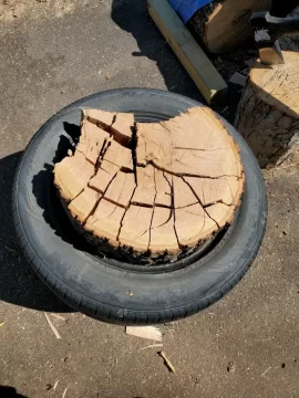

I burn a lot of red oak too. I just look at it menacingly while holding my Fiskars and it splits itself into perfect slabs. Easiest wood ever to split for my money. I do the majority of my splitting with the axe. Maul/sledge comes out for knotty or starting huge pieces. Will be purchasing a splitter soon but I still enjoy the by hand workout.
