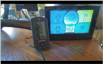

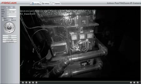

I use a couple cheap Foscam R2 IP cameras to monitor my furnace.....various temps, draft and level of burn on the computer while I'm at work. They can also be used on a phone with their app. It allows for complete remote control of it as well...pan, zoom, tilt. Also has infrared for dark places. See attached.
[Hearth.com] Wood Burning Safety When Not At Home?
Basement is in complete darkness.
I like electronics as much as the next guy, but I simple never felt a need to monitor the furnace so closely.

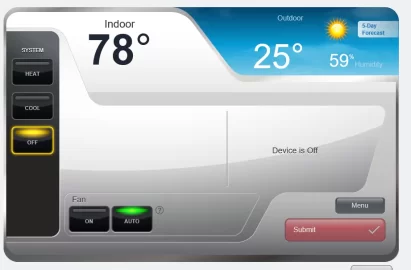

I was never nervous about it. I don't do it out of a necessity, I do it as a hobby, it's my obsession during winter....lol I like to know the firebox, plenum, stack, return air, supply air temps as well as outside air temp at our location (we are normally a few degrees colder by us in the lower lying area than what it shows online). I don't cut firewood out of need either, but as a hobby, and I have PLENTY.
Running a Kuuma is pretty uneventful and I too have my routine. There is no waiting for anything though, unless I'm starting a fire. Then I just have to wait a minute or so after striking a match for the primary damper to open and then I can load and walk away. The computer takes care of the primary air damper for me. I just like to play with things to see how I can improve on the results, that's all. It's just my personality. My other half is constantly asking me, "can't you leave ANYTHING alone?!" You need data points if you want to improve on those data points. Although the firebox one is just for fun. I have not, or will not try to mess with how it burns, as it's already optimized. Most all of my playing around has been with my return/supply air. How to increase the delivered efficiency and more effectively get the BTU's to show up as increased house temp. I have succeeded in doing that and would not have been able to do it if I was not monitoring those temps.
One thing which could come in handy down the line monitoring all those vitals is if anything should ever go out of whack, it would be pretty easy to diagnose if noticing one of the vitals is out of norm. If you don't know what norm is, you'll never know if anything has deviated from it It's establishing a baseline for any future troubleshooting one may have to do.
Take for instance right now. This morning I forgot what the forecast for today was going to be, so I guessed at how many lbs of wood to load. I believe I loaded 35lbs. I came upstairs and checked the forecast. As soon as I saw mid/high 20's and sunny, I knew I had put too much wood in, and told my GF just that. I can check from work to see the house is currently at 78° and at what state the Kuuma is at 6.5 hours after loading (firebox 800°, 115° plenum temps)....along with all the other temps can tell I have ~2-3 hours more of heat left. I just like the ability to see this stuff while at work. It also confirms I did load too much wood. ;lol
