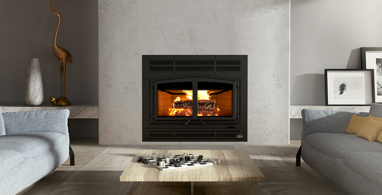

Hello and welcome! How about a high efficiency fireplace
Thanks. The website doesn't seem to have any technical details or measurements, which is frustrating.
It sure does. Click on one of the products, scroll down to "Description ", it is a drop menu, click on it and select "Specs/manual". Interior and exterior measurements will be found by scrolling down. Pacific Energy has some nice units too
