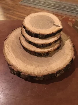

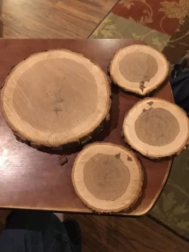

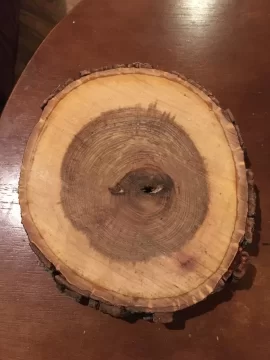

While looking at the end cuts of some of my wood, I got to thinking about what could be made with it. I'm thinking coasters, cutting boards or plaques of some sort. The first picture is a 6” slab of hickory, the others are white oak. I think cedar would be a really good to make something with. I'm sure a mill would really take it to another level. With Christmas right around the corner it could make for a nice gift. Has anyone else here made anything with the wood they've cut?

Those are like perfect slices. They tend to want to crack like that. I’ve made a few clocks and tables out of burrows. I’ve e seen some slices like that banded and made into things. I’ve also made some live edge stuff that turned out really cool.

I haven't thought of clocks, that would be good for the larger oak slice. Maybe even the smaller slices for a desk clock. Our neighbor made a live edge coffee table, it's definitely a work of art.

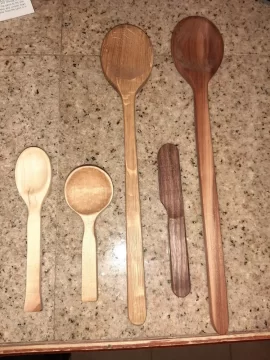

Yep. These were once cherry, oak and maple firewood pieces. The butter knife is walnut. It's simple but I enjoy it.
I like these, my wife would love something like this. How did you do it? They may be simple, but I bet it was time consuming!

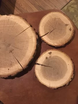

As stated once the cookies dry out, a split typically occurs unfortunately. The thinner and bigger diameter the cookie, the faster it will happen. 6" diameter might be ok. If you put a finish/sealer on it quickly you .au be able to trap the moisture inside to prevent. But maybe not....
They do not split right in half typically, so your time and effort is not wasted. Limbs will stay together better than a pice from the trunk....tighter grain helps

To prevent checking, as soon as you cut your round put some linseed oil on it.

Good to know, I'll have to try some linseed oil. My wife said we have some somewhere. And yes, they are already checking! :)

I’ve seen them banded but not sure if there was any special kiln process that went with it. If you find any burrows, they won’t crack or check but the bark will come loose
