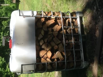

I use this now
  • [Hearth.com] Wood in a basement. Is this a bad idea ?
