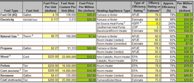

Here's a cost comparison ....just raw numbers...showing the $$/million btu's for a bunch of fuels. The numbers I have plugged in for wood and pellets are local prices here in Michigan but I would think they'd be close
[Hearth.com] Wood Or Pellet Boiler? Musings. to yours too.

I looked at that eia spreadsheet as well, with some other numbers. Who'd thought fuel oil around here would be $4.19. Not sure what pellets are going for, but I'm thinking around $250 around here. My wood is about $100/cord, but only because I get log loads-in the papers for split and delivered it's more like $225. The point being that wood cost comes closer to pellets when bought in a similar format, but savings can be had if putting in the work processing the logs. Pellets still half the price of oil though. (And I would ignore that propane number, for now anyway.)[Hearth.com] Wood Or Pellet Boiler? Musings.

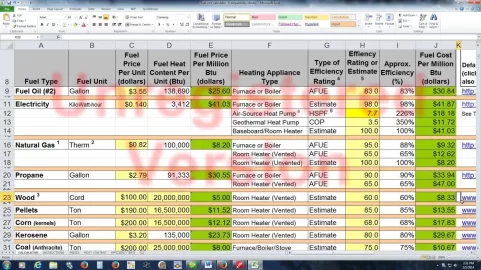

The efficiency number on the pellets is wrong if you are going to use a Windhager like you mentioned. Combustion testing on mine has never shown less than 84% and usually it is in the 85-87% range when I give it a sniff.
That would bring your pellet cost per million btu's down below the 18$ mark.
If you wind up with a Harmon or something similar you can plug in 70% for a real world number.
