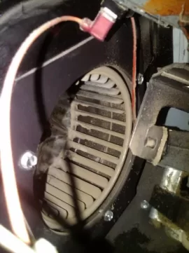

    This is my 1st yearly cleaning for Avalon Astoria or similar Blowers. The instructions do not say much about cleaning the very dusty Convection Blower. Thanks to Imacman for telling me about how he removed his. Like his stove, the convection blower is shock mounted and the right side door can be opened to remove the two closest bolts. The back front can be loosened and then the back must com off to loosen the back bolt. Then the blower can slide out if needed and the wires be disconnected. Then a soft brush like an old tooth brush can be used to clean the slats in the squirrel cage. Care must be taken not to dislodge the clips (Balancing Weights) on the fan slats.
    After opening the back door, I can see the slats that need cleaning and of course the whole inside should also be vacuumed of dust. Now my question is?
    Can this Convection fan be cleaned in place easily. I have been searching the web and found a mini data vac on the staples web site that just may do the trick! The store clerk said it can only be purchased through their web site, otherwise I would have it by now!
    I have seen other battery operated mini vacs but this AC mini vac is 4 times more powerful! I am sure that is need for pellet stoves!!
    Good
    http://www.staples.com/Metro-Data-Vac-PC-Personal-Cleaner/product_784512?cmArea=SEARCH
    Better
    http://www.staples.com/Metro-Data-Vac-Pro-Next-Generation-Series-Cleaning-System/product_784520?cmArea=SEARCH
    Best
    http://www.staples.com/Metro-Data-Vac-Pro-Computer-Cleaning-System/product_463985?cmArea=SEARCH
    The best one is probably what the pellet stove serviceman uses but I thing the good one will work for me just fine.
    So has anyone used something like this??
    See pic below of dirty dusty Convection Blower and I wish the stoves had a nice air filter! ( I know must be fireproof! )

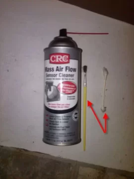

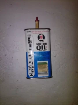

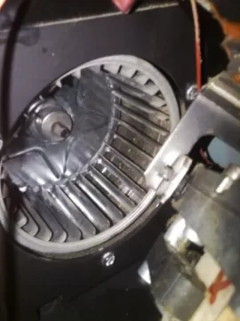

    Well I ended up removing the Convection Fan with a 1/4" socket for the bolts near the door and 1/4" wrench to loosen the other side and the convection fan slipped right out.
    Then I oiled the motor with 3-1 SAE 20 in the mini Oil Can after carefully removing the Yellow plugs with my finger nails!
    The mini-vac did not work as well as expected. In fact the small paint brush and shop vac worked fine to get the dust out. Then I used CRC MAF cleaner similar to the electronics cleaner to spray the metal slats in the squirrel cage. Then a Q-Tip to get the tough spots. Then I sprayed the metal squirrel cage with the Spray Graphite and bolted it back in.
    Then I gave the whole back inside a good vacuuming and dusting and put the back back on. Whew!
    That should be quite good enough for another year since I only burn 3 tons.
    See pic of clean convection blower, crc cleaner and oil. All CRC type cleaners are available at AutoZone.

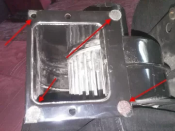

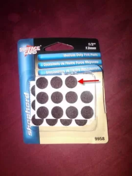

    Well this year there was a new problem with the Convection Blower. The Surface Pads were very warn. One even fell off!
    So I got some more black color felt pads at Home Depot for $3.19
    They are called Surface Gard - Medium Duty Felt Pads that are 1/2" or 12mm made by shepherd LLC.
    As you can see from the pics below.
    Upper left pad - fell off
    Bottom left and Upper right are very warn.
    Lower right I just replaced with a new pad.
    So I replaced all with new pads to be safe. It should keep the vibration down to a very min!
