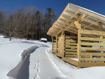

Each bay hold a little over 3 cords, which is around what we burn in a winter. I don't season wood before putting it in here so I wanted it to be as open as possible. Originally I planned for it to be all on one level, but once I started digging to level the space out I hit ledge 6" below the grass... so I ended up with this tiered design.
I've seen that shed somewhere before... :)
Planning for my own mini woodshed next year. How much overhang do you have on the front? It looks like it's been enough to keep the rain and snow off?

IIRC it is about 24" of front overhang and about 12" of rear overhang. It does seem to keep the snow off well, and since the front faces south... any snow that does blow in either melts or sublimates pretty quickly.

Nice, good to know...thanks!

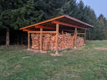

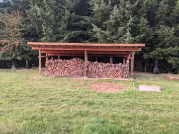

Almost finished with mine. 12' deep and 28' wide. 2' of overhang on each side and back and 3' overhang on the front. I am going to put more 2x6's on the side spaced out to allow airflow and trim the front header in metal to match the sides. I also decided to coat the whole thing in a mix of 50/50 diesel and used motor oil. 6x6 Posts are on concrete bases and brackets so this woodshed should outlive me.

Very nice, clean and simple! I also love those evergreens (not sure of the correct term) in the background. I wish I had some of those on my new property but we might plant some along the frontage as the family we purchased the property from sells christmas trees (he might actually grow them, not sure of that yet) upstate NY.
Thanks. I will post more pics when it's finished and loaded. Yeah I've got Doug Firs on the land around me and have planted more throughout the property. The Fir and pine have a much higher survival rate compared to the various cedars I've planted. Just a warning. Keep them surrounded w/ a barrier after they establish because when the deer are in rut they will rub them into toothpicks!!!
