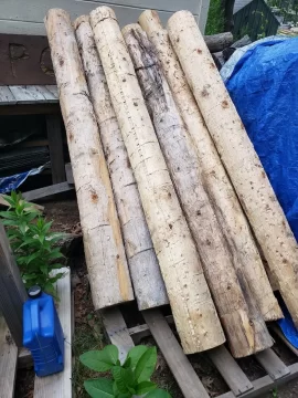

I scored these 6ft cedar poles basically free. I have an area maybe 12-14ft x 8-10 feet. I really want to make a roof and just put pallets under it and stack my wood with some wood slat sides on 3 of the sides to allow air flow. My issue is that area of my yard is basically rock or very hard just below the surface. I suppose I could dig a hole to the rock. Pour some concrete just to level it for the post. Then drill and anchor the post into the rock? 6 inches or so? There is no way of me moving this rock out and adding a sonotube. I do have other scrap 2x4 laying around. Might need something bigger for the roof support stretching from the beams which I understand. Really looking for any ideas. I'm sick of looking at the tarps and they wear out way to fast.

I like that. My posts may need to rest on cinder blocks of I do it that way because of the size. Wonder if I can do it without the floor. PT is crazy money and I have unlimited access to pallets.

PT is pressure treated lumber. My yard is small and fenced in plus I did sod recently in the front part. I have access to machines but this is just ledge. Id literally have to jack hammer it all up to pour. They make anchors and expoy for setting fence posts on on top of rock. Not a bad idea with those concrete posts and maybe some 2x6 as the base then setting my posts on that. I'll have to price it out.

I’d just make it freestanding and set it on flat rocks or blocks to help level it. I’d screw (only 1 screw each end for now so it’s easy to level it after the other 2 sets of poles are up) 2x between the posts to make the roof pitch an and other near the bottom. Repeat for a center support and end. Stand them up screw on a back “header” so now it’s all free standing screw on the front header add some roof supports front to back and then string perlins across those for your roofing material of choice. Simple and fast. I’d just rake the snow off if I thought I’d might be to heavy. With nothing but firewood under it I think just sound enough is fine. I was going to do this with landscape timbers but I have a 5 cord stack right where I want to put it so it’s gonna wait. Maybe lumber will go back down by then.

Great options on here. I need to move the wood currently there to my rack near the house then start leveling it out. Thanks!

If the ground is really hard and dry you could sink a 4 or 5 foot length of rebar into the ground as a pin to hold the log in place. Drill a hole up the log a foot or two. If you really don't want the log touching the ground set it on top of a couple bricks or concrete pavers with the rebar in the center. If you have rocky glacial till like here you may have to make several attempts at stabbing the ground and you may have a slightly not-square building. It's a wood shed.
