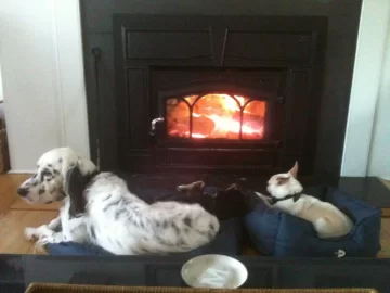

Inside center chimney, 6" SS liner insulated at top and bottom (stuffed with Roxul) but no metal block off plate. Installer felt the block off plate was unnecessary and I did not know enough to argue at the time.
Debating replacing the insert or leaving it in the fireplace and installing the Progress Hybrid at the end of the house/Cape near kitchen and family room. PH would be straight up venting double wall pipe inside the house but shorter stack maybe 16/17 feet vs the 23 foot existing fireplace chimney.
Sorry to hijack the thread but have been looking for people that have gone from a small insert to a Progress Hybrid or Ideal Steel. Really appreciate the feedback.
keeps the dogs happy!

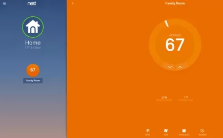

I went from the BK princess insert to the PH. I loved the BK, long burn times threw some nice heat but the PH is a beast compared to the insert. My insert struggled when it got below 20, right now it's 18 and my office is 71, the burn times are close to the BK but not quite as long. I load one full load and two smaller loads or two full and one smaller when it's cold. The nice thing about the PH is the soapstone holds the heat a long time so even when the loads almost burned down the stoves still hot.

I would like to see a picture of your fireplace hearth and insert. sounds like you have an interior masonry chimney also(which is good). mine was an exterior but the insert performed better than expected. I bought it used of the Hearth classifieds. If you plan to keep the insert I bet we(hearth) can help you tweak it!
A free standing fireplace install may save you some coin if the layout permits, since you could utilize the liner in the interior chimney.
NP hijacking the thread, conversations go that way around the Hearth!
Sorry didn't see the attachment earlier. I noticed that your stove part of the insert is deep into the fireplace. on mine i could adjust the stove to stick out past the fascia plate. more stove in room the better.
