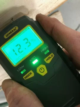

I have a 2 prong moisture meter. the wood is stacked next to the stove and is under 5% moisture. Insert prongs in the end of the wood.
I also checked it against the wood in the garage and it is up to 15%.
My understanding is that the correct method of measuring MC is to take a piece of wood that has been at room temperature for 24 hours, split it, and insert prongs of moisture meter deep into the fresh face of the split. Measuring MC at the end of a split will give a very inaccurate reading.

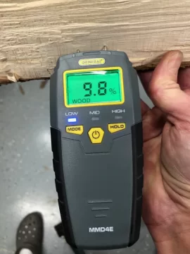

Here are two pieces of wood I took out to the garage to split after they had been in the wood box by the stove for at least 24 hours - probably closer to 36.
Test it as described above in post #8 and let us know what the actual M/C is. There can be a really significant difference compared to measuring the dry exterior.
That certainly looks plenty dry. But 5% simply isn't possible without a kiln.

If he knows someone else with a moisture meter well worth retesting and comparing, however I would doubt that wood is above 15%.
The wood in the pictures are stacked 30" from the wood stove. The firewood I burn is 12" so the previous row I was burning was even closer.
I will split a piece when I get home and test the inside as suggested.
