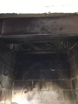

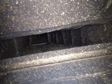

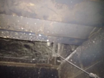

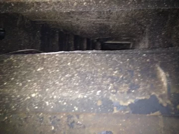

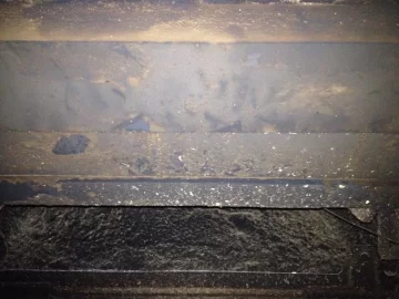

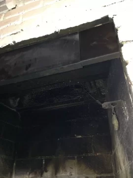

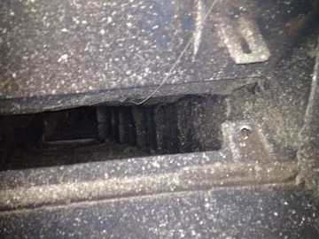

Oh well, I finally got the PE dealer out to the house. I thought I had all the measurements right. Except for the depth of the fireplace ceiling. I think its called a lintel. Anyway this lintel is pretty deep to where the flue goes up and out. Around 19-21'' from front of the hearth.
I have a masonry existing fireplace. I have/had a deposit for a PE summit insert. Unfortunately, it looks like that will not be able to be installed.
[Hearth.com] Wood stove insert for my hearth conditions? [Hearth.com] Wood stove insert for my hearth conditions? [Hearth.com] Wood stove insert for my hearth conditions? [Hearth.com] Wood stove insert for my hearth conditions? [Hearth.com] Wood stove insert for my hearth conditions?

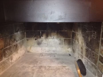

I know the pictures are not the greatest. I am trying to show the depth of the lintel from the front of the hearth to where the flue is.

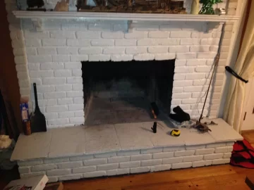

Merged this with the previous thread for continuity. What is the issue? Won't fit? We can't tell too much without full dimensions including H & W in front and the back too and for the floor to the lintel. Also include the top and bottom depth measurements too.
Also, what is that big (steel?) curtain in the picture with the brush? Is that the "lintel" If so it almost looks like a deeply embeded heatform fireplace.
Can you provide the dimensions requested in written form?
That is a smoke shield
Is smoke shield the problem? If yes, can it be removed?
Fireplace Measurements
A = Opening Height = 26 3/8"
B = Width in Front = 36"
C = Width in Back= 26 1/2 "
D = Depth of Fireplace = 27"
E = Hearth to Mantle = 42"
F = Hearth to Combustible Mantle bracket = 37 6/16"
G = Height of fireplace floor to lintel = 27 1/2"
H = Width of Hearth = 82 1/2"
I = Depth of Hearth = 18"

Smoke shield was put in to help with using the fireplace in its current condition. It is on a tension rod, can and would be removed prior to installation of stove.

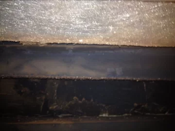

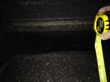

Not the problem. Problem is ceiling of fireplace (lintel) to where the flue is
At 26" high it would seem like there is a lot of wiggle room, but obviously that is not the case. Is the issue that the damper frame is much lower toward the back of the fireplace? Is that where the 19" is being measured?
No, it is that it is that deep, actually closer to 21". Height is roughly consistent.

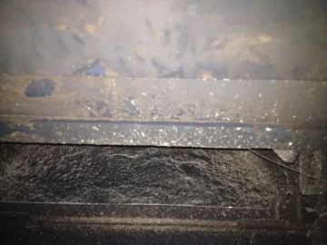

See where the wire goes up to the top of chimney damper. That is approximately 21" from front of fireplace.
That is what the technician(installer) said was the problem. It is too much of an offset supposedly from the top of insert vent to the flue.

Normally the throat of the chimney could be cut to reduce the offset. Mine was done that way to allow the insert to protrude into the room.
Did the installer mention if this was possible? It isn't unusual to modify the fire box or throat to get the insert installed.
He balked a little. I will inquire again with a more detailed question.
I am looking at this and I am wondering why I can't modify the plate right before it goes up to the flue. The fireplace looks to have the old damper still in place except for the movable door. At some point that was removed and an Accordian style rain cap/ damper installed on top of Chimney. A long wire cord comes down flue and goes to a bracket close to the front of fireplace. This cord is pulled tight to bracket to close or released to open.
