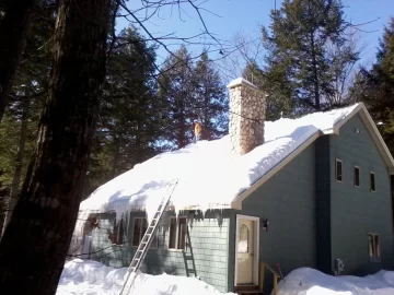

Is the chimney on an exterior wall?
The interior flue tile size is very important. If the inner area of the cold stone flue is large, the stove is going to draft poorly which will make the stove hard to start and will greatly exacerbate the puffback issue. Check this out or ask your chimney sweep for the dimensions.
Thats a negative. The chimney is within house. I put a picture below.

Don't know where you are in NH, but looks like we both have just about the same amount of snow.
Well, actually that's a positive. :) It will help keep the flue warmer.
That's quite a bit of snow you have there.
Yup. I love New Hampshire and wouldnt live anywhere else, but I could pass on the snow if I had my way. I see your from WA. Was there in the 80's at Ft.Lewis and loved it.
If your SW NH I'm between you and Concord. This is my first house with a wood stove stove though. Other than what happened last night I love my Jotul. It heats up the house great.
