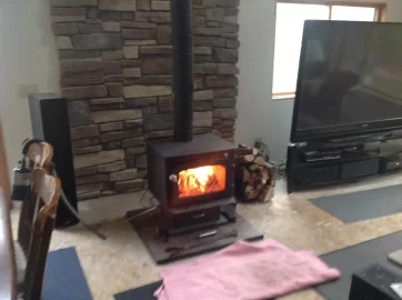

I also live in NW Wisconsin.A couple of acres won't supply you with a sustainable amount of wood but up here wood is plentiful and I get all of mine from lot owners within a few blocks from my home and maybe you can ask aaround and find scrounge wood too. I put my Drolet wood stove in 3 years ago and its the best thing I've done to the house. I thought about putting it downstairs at first but to monitor the fire and enjoy the heat better not to mention the savings from not having to install the additional class A duct vents out the chase was the way to go after some thought. I bought my stove on clearance at Menards in Rice Lake for $599. Its not a popular brand here but It works great and can heat my 1700 sq ft of upper levels and radiate it to the basement as well on even the coldest of nights but tomorrow night will be the real test at -35 to -static.Chow [Hearth.com] Wood stove seems like a great idea... does it?

(hermancm: your little stove is beautiful!)

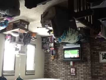

This looks like a small fireplace. We'll need some dimensions. It is arched in front? From what I can see I suspect you would need to tap in above the damper with a thimble and put a freestanding stove in front of the fireplace. Is there room for this?

Thanks, begreen, I took the pic with my tablet (hence, low res). I have another pic of the whole living room (which you might also have to fix because it's upside down... sorry, and I can't currently upload direct from tablet because tablet internet connection is somewhat sketchy today)[Hearth.com] Wood stove seems like a great idea... does it?

Thanks, begreen, I took the pic with my tablet (hence, low res). I have another pic of the whole living room (which you might also have to fix because it's upside down... sorry, and I can't currently upload direct from tablet because tablet internet connection is somewhat sketchy today)View attachment 122932
Upside down or not, I expect you're going to get a lot of compliments on your TV, and a lot of requests to move it because it completely blocks the view and info needed to give you sensible advice.
