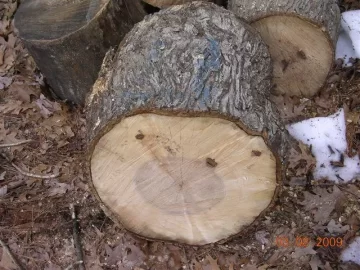

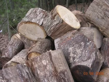

I have some wood that I have all bucked and need to split. I have been able to split some with an ax, but it's hard, hard work.
Could someone please tell me what type of wood this is?

yep, I would say maybe Pignut hickory...are the splits kinda stringy and pretty straight grained?
That stuff is, yes.

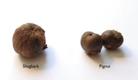

The left picture is white oak and hickory, the right picture maybe Pignut. A few years back I was fooled by what type of Hickory I had in my pile......so
I read on a website somewhere ( I forget where) about Hickories that "Hybridize" and makes bark ID hard for even a seasoned Arborist.
Alot of times... bark, leaves and nuts are needed. Look around on the ground "Pignut Hickory" drops much smalled nuts than "Shagbark Hickory"
I have a pignut on my shelf and a shagbark nut....I will take pics.
WB
I have some logs like the ones on the left and was told it was hickory too.
It splits pretty easily with my 8lb maul. The stuff on the right ??
Some Hickory nut pics.
These nuts had such a green color to them back in the fall.
WB

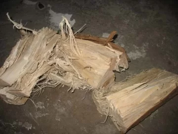

Does it look like this?
  • [Hearth.com] Wood that is next to impossible to split by hand - what is it?
Jags said:
Spikem said:
I also have stuff that even if I use a log splitter, it essentially pulverizes it - it really doesn't split it. I'll post a pic of that when I have a chance.
Exactly like that!!!
It's the nastiest stuff I've ever seen! Rounds that were 12" in diameter put a bit of a strain on the Troy-Bilt 27 ton splitter I used!

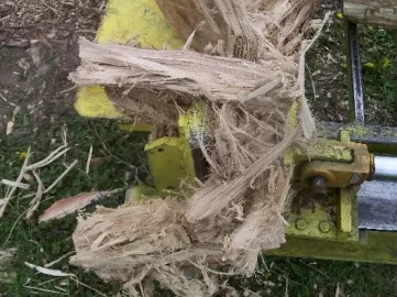

Welcome to ELM! my friend. I have seen rounds that would stop a 20 ton and laugh at it, barely denting the end. My machine doesn't have a problem with them, but as you can see, stacking can be a real b!t@h. :lol:
Disclosure: not all elm acts like this, some split somewhat reasonable, but the pic was of an overly season, dead standing, petrified bastage, that simply wouldn't give up the ghost. The whole dang tree was like this.

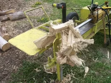

Here's another one for your viewing pleasure:

Comparing hand splitting hickory to elm is not really a fair fight. I have seen monster mauls bounce off of elm repeatedly. I have stuck many-o-wedges trying to get a crack to define itself. That stuff is pure evil to split by hand. But I have also noticed that from tree to tree, there can be a huge difference in the difficulty.
