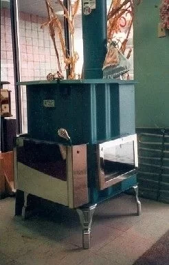

This is the official US site. www.sedoreusa.com
These stoves are for real and are being manufactured in the US now. The website is under construction but will give you the basics. The Sedores do everything thats claimed and more. The ones I'm making here in the US come with a 6" flue as that is the recommended flue size for the stove. The Cadian's used 7" because up there they can't go from 6" to 8" pipe so they use 7" to make the stove compatable with either 6" or 8" pipe. The wesite referred to in an ealier post does describe the stove but the companiey has been sold and there is a Canidian and US manufacturer, both with different websites.. I dont have the new Canidian website address right now but will add it later for those interested that live in Canada. The stoves are different looking but will fit anyplace any others do. There are options that make the stove more attractive and they look different because of the operating principles. I have had my Sedore burning straight for six months without shutting it down and it always burns for 8 plus hours depending on the fuel being burned. I tipically gets burns of 12 plus hours and the stove is easyiest to operate I've used or seen. Once its going you just add fuel fuel twice a day. Other advantages are the top loading, it burns wood, pellets, corn and 12 other fuels. The stove is ULC approved for 15 different fuels so you can burn most anything eliminating the need to be concerned about going with just a wood or pellet stove. No electricity required is another big advantage and they can be shut down and run at 100 F on the stack and go for up to 30 hours on one load so it doesnt blow you out when its warmer. As to wood splitting the Sedore does not require much wood splitting because they will take wood as big as will fit into the chamber. Once the stove is got a head of steam it will even burn wet and green wood. The key is to start it with seasoned wood but once it has a head of steam going it will burn any old crappy wood available. The Sedore is truely a stove that does things no others do and is as simple to operate as any, with three moving parts. I think it would be good for everyone to see one in action as that's the best way to judge what this stove does? I've been burning wood, pellets ,and corn for many years but have seen nothing that compares.
I'll admit they are a bit (different looking) but one grows accustomed to them quite quickly due to the versitilly and capibilities of the stove. They come in several different sizes to fit your application. Please take the time to see one in action because I know these claims are hard to believe, Please feel free to contact me about any further questions on the Sedores?

Bruce, is there any movement within the company to redesign the exterior of the stove? I respect the flexibility of the stove and like it's ease of use. But it in all honesty, it would never get closer to my house than the workshop due to looks. The current design of hanging plates of marble or tile on the exterior lower half looks like a dolled-up RV. Seriously, I think these stoves could (and should) sell better by hiring a good industrial designer to come up with a new look. Don't change the efficiency or ease of use, that is a real strong point. But perhaps consider making it look more like a kacheloven?
Be Green,
There are several things in the works for redesigning the stove but at this point we have to get off the ground first. I also don't like the tiles on the stove and that's why I don't offer any of those items you see one the Canadian website. Its a real basic stove and those items don't do anything for me. I guess I'm so used to the different look that it doesn't seem to look that bad but I've also heard it from others. There will be a furnace coming out ASAP but it also is not your glittery looking stove. Its a good question about changing the looks but the whole design concept works on having the corrugated sides for three reasons. 1. Strength these stoves do not have firebricks inside so this is important. 2. More radiant heat surface. 3. The corrugated walls keep the fuel inside from choking off the natural circulation that happens inside the front chamber. The fire only burns at the bottom of the stove but circulates the heat and gas's around the entire load which is how it conditions the fuel while its dropping to the fire. There is a second chamber in the back which pulls air when all the particulates are burned from it and becomes light enough to be pulled under the baffle into the back chamber and out the stack. I have to look into your idea about casing the stove with a more professional looking exterior but it will be a while as everything has to be approved by UL. I'm just getting to the point where I have more time for design changes so we'll see what comes of it? I have looked into having the stove powder coat painted which would help but you would still have the corrugated walls which seems to be what most don't like the looks of? I appreciate your honest input and will be looking into some options for improving the looks. I would have to build a prototype with a jacket around the stove and make sure it doesn't have any effects on the operation. Some people are putting them into there homes including myself but I will admit they are not the most attractive stove out there. I feel that once you see one work and how little fuel they burn, and the long burn times they start looking better. It is definently a look one must get used to, but the benefit's are many as far as the wallet is concerned. I'll post some pictures of some of the new models soon which I think look somewhat better.

Welcome aboard Bruce, and I hope you do well with your stoves. The design does sound good in terms of capabilities, but I agree with many of the others that it needs some improvement in the "looks" department. (Though I do consider how it heats to be more important than how it looks)
Going from your website (and the site mentioned earlier that I pointed at) however, I would mildly challenge your statement that a Sedore "will fit anyplace any others do" - as I don't think it would fit in my application... This is NOT intended as a general dump on the stoves, as there are MANY (most?) stoves that will not fit in our space - (I think it may have been my earlier remark that prompted the "fits anywhere" comment). This includes all the Englanders, PE's, and many others, all of them good stoves but just not ones that will physically able to go into our space.
From the pictures on your site, it looks like all the Sedore stoves are quite tall, or at least taller than most standard design stoves. In addition, they all appear to have top exit flues. We have an extremely unusual chimney setup, and unless we want to do a MAJOR rebuild on it, we are limited to stoves that have rear exit flues, and a maximum height to the top of the flue of no more than about 30". OTOH, the top load is excellent as it would presumably mean lower requirements for front clearances, and possibly mean we wouldn't have to extend our hearth, which any front load stove would demand.
If I'm wrong about the dimensions and configurations on your stoves, let me know, but from what I've seen so far, it looks like your units don't make my "short list" much as I might wish otherwise.

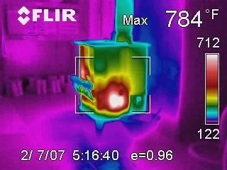

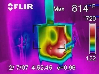

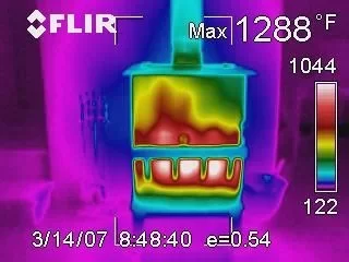

I want to thank everyone for they're support as I know it will be a tough market to break into competing with the giants in the stove industry. I appreciate your honest comment's about the stove, as these issues will have to be considered. I've already found that just having a product that will do many things that the others don't won't sell the stoves alone. Any constructive input will certainly help me in the future.
As for Gooserider, you are correct that my statement about my stoves fitting anywhere others do stands corrected. All three models are 40" high and I was not thinking about the stove height as being a issue. It certainly would not fit in your area without major renovation. I will still however stick to my guns on the fact that these stoves will out perform any others and can hardly wait until this can be tested? I know quite a bit about stoves, but on the manufacturing and marketing end I'm continually learning. Anybody out there that would like to see one in action please contact me. There are not a lot of them around but I do have a dealer in Cortland NY were the stove can be seen in action if that's doable? I am trying to establish dealers in other area's at this time and will post about them as they come on. The biggest problem I'm facing right now is that the transaction of purchasing the US right took so long that I missed most of the heating season. I will keep plugging away on it though as I anticipated that this year would not be prosperous. Its been a long hard 2 year struggle to get this far and I can at least get a stove out to customers in a week now. I still don't think the stoves are ugly but I'm used to the look and biased. One really has to see one in action personally to really get the full picture and that will take some time? Again thanks for your input as it is extremely helpful.
I'm attaching some IR Images of the stove as it tells a bit more about stoves ability to put out lots of heat with 200 F stack temp.
