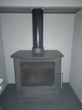

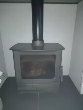

Yes, new problem. Weather mild. I've noticed when I turn it up full damper fully across...nothing. I also noticed when the chimney sweep swept it he didn't remove all the bricks. I'm wondering is there a build up of soot behind the back plates which could be hindering the throat plate opening and closing. Don't know! Not burning as it used too. Burning very low.

Heat woodburning multi stove. Galvanised flu full length of chimney and cap on it. Stove working the best until mid last week. Cleaned on Friday, but as said didn't take all bricks out.

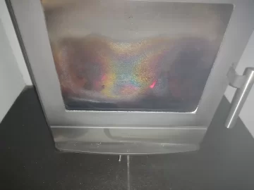

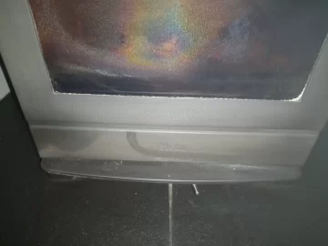

Your pics of the loading door glass look like your burning really wet fuel?? Hard to believe if this just started happening. Even with warmer temps. Hmmmmm.
Reactions: stoveliker
That looks like not enuf air intake, possible bad wood, and/or shutting down too early to cause that much window discoloration.

Cheers, flu 6m from fire to chimney.
