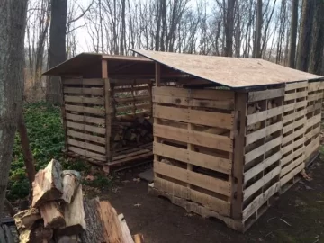

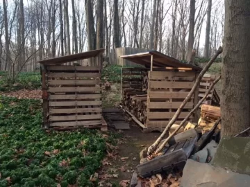

Looks like we need more wood for the winter than we thought, so we doubled down and made a twin to the existing woodshed...bonus pic of the dog "helping".

Looks nice! Pallets, genius! Thanks for the idea. I know what this weekend's project is gonna be!
Reactions: 2PistolPacker
Cool! All the lumber except the roof sections was free, and it should allow good airflow around the stacks. I was able to stack two rows in each section, with 6" to 8" between them. The area of each ends up being 4x4x10, which is a little bigger than a cord each.
X2, great idea!!
I'll be going to Tractor Supply tonight to get more pallets to duplicate this weekend.
Nice job... I also plan to copy your idea.
Your Lab has a future in banking, looks like he's already a "branch manager" That is one of the most ingenious wood shed designs I've seen, good work.
Ha, thanks!
For the record, it's three pallets for the back, three for the base, one for each side. Where it was difficult to screw the pallets into one another (they don't always line up if they're not from the same batch), I used nail plates from Home Depot...just screwed through them and into the wood. Used the 90-degree ones to anchor the sides/back to the base as well.
I don't know if you can see it that well, but there's a cross-beam across the middle of it from side to side. So without the roof on, it would look like an "H" from above. That's to keep the sides from bowing out due to pressure from wood stacked against them on the inside. It's in the middle instead of right at the front edge so we don't crack our heads into it every time we go to get or stack wood.
The roof is 1/2" OSB. The pallet structure is 10' across, and the roof is 12', with a 1' overhang on each side. We got 4x8 sheets of OSB from Home Depot, and had them cut in half..then used three 4'x4' pieces mounted on 10' long 2x4's to make the roof portions. I would have rather used plywood but it was 3x as expensive. We'll see how this holds up.
I figured out that I could put a shingle roof on both for $90, but we're holding off on that for now. Just gonna use 3mil plastic sheet, stapled on, for this winter.
http://www.homedepot.com/p/Simpson-...nized-Steel-Angle-A21Z/100375047?N=5yc1vZaqzs
http://www.homedepot.com/p/Simpson-...C-_-NavPLPHorizontal1_rr-_-NA-_-100375260-_-N

I'd at least paint that OSB if you aren't going to put anything over it. OSB will deteriorate fast. I would expect 2 seasons max, probably less with your snow.
