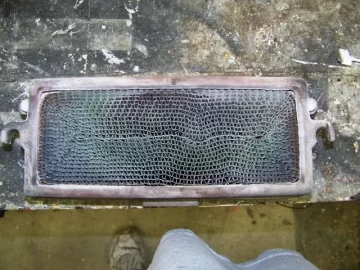

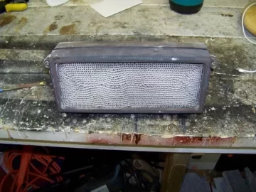

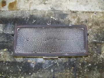

Little update. It's been a little over a month of burning with the old scoop and s/s cat and I noticed the stove to be burning a little differently lately, so I took out the cat this morning. There was some fly ash in there but it doesn't seem like a lot, you can still see through all the cells. Maybe it was enough to cover the face to effect the burn? Here's some pictures.
Also noticed the exhaust side of the cat was turning green. I don't know if you can see it or not in the picture but it looks kind a like copper when it has some of that green corrosion. Anyone else notice this with there s/s cat.
Another thing I noticed is the cat gasket is starting to disinigrate in the corners and I can see through two of the corners so I stuck a little rock wool insulation in the corners to fill the holes.

I'm going to switch back to the s/s scoop and burn it for a month to see if there's any difference in fly ash. Pretty easy switching back and forth.
I checked mine at between Christmas and January 1st and it looked great. Some fly ash, but not much.

That green color is interesting. I wonder what reaction is causing that.

I'm starting to wonder if that green is killing my cat? Stove takes longer to come up to temp, doesn't get as hot or stay up to temp as long as it did earlier in the year. It still burns clean and my cat temps still go up above 1500 but stove top temps are lagging. I'm calling Woodstock to see what's up.

Todd, some conversations with those in the know, pallidium, the major consist of the wash as its cheaper, will tarnish when above 800c. Theres a resulting reaction with available oxygen making pallidium 2 oxide. Then there was some jibberish i didnt get but the resulting sulpher i did. This can lead to the green effect or coloring you see.
This is third hand so take it for whats its worth.
I wonder if when heated that hot, its pulling air in from a loose gasket or similar making that occur on the surface of the cat...did you hear back from woodstock?

So, it sounds like it may be a normal reaction. I'm suppose to get a call from them tomorrow but after sweeping my chimney I think I may have a bigger problem. I'm going to have to take apart my pipe and have a look through the crock, I think I may have some build up or something in my horizontal run, I can't even get the stove up to 500!
A leak in the chimney pipe could be causing this in flux in oxygen levels. Not sure how it would or could get to the cat. Just a guess.

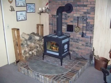

I think your right. Took off the pipe this morning and it was full of creosote. Posting some pics in another thread. I also changed back to top venting, the rear vent added an extra 90 and I think I had too many pipe seams leaking air.
See now i always wondered if the reversable flue collars actually affect much. Id be hard pressed i think to include that 90 in the overall equation. I would think there has to be some distance from the flue exit to start adding up 90s.
Good luck though. Post some pics of the new setup. Never tire of seeing that.

Here's the new setup with a top vent. No more cat probe through the top, guess I'll have to buy a thermocouple.
