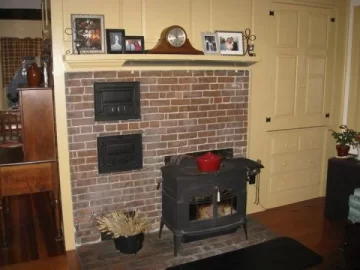

Look at are current generation EPA certified stove. You will be glad you did. For example here is a catalytic stove installed in a c.1800 hearth. They were able to get the 6 inch liner up through the old chimney no problem, you might be surprised how big the inside of those old flues are.
  • [Hearth.com] Woodstove in an old chimney
