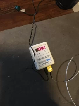

I wonder just how much I should be concerned about my thermometer readings. I have a Rutland burn indicator on the top front of my 2004 Lopi liberty stove and a Flueguard Probe 18 inches up in my double wall flue pipe.
According to my flue pipe thermometer I should be running my stove cooler, but according to my stove indicator, which I know isn’t completely accurate since it’s just on the top of my stove, I should be running my stove hotter. According to my house temperature I need to be running my stove hotter.
what do you all recommend? I’m trying to heat my house with just wood, but I don’t wanna get to the point where I burn it down. I’m also considering adding a damper to my flue pipe to help hold more heat in my woodstove. Would that be OK with a Lopi Liberty?
Here are some pictures of what the two different thermometers say at the same time:

Here are the readings After readjusting the air mix a couple of times

Is that single wall pipe? It must be since you are using a surface meter. With screws above the seams it may be upside down.
I like to use an IR temperature gun for the stove top. I have found that the magnetic dial is pretty slow to respond.
I have a probe like yours, but I don't know the accuracy of it. I expect that it is not very accurate. I am in the process of upgrading to a thermocouple probe.
That being said, having the flue probe in the red makes me nervous. With a newly swept flue, 1000 would not scare me too much but I would do whatever I could to bring it down. If it had been a couple of months since I had swept, 1000 would make me pretty nervous. That is right about the temperature where creosote can light up.
Seems like you would have to have a lot of air flow through the stove to have your flue that hot while keeping the stove top relatively cool... something like a fireplace with unrestricted air inlet and lots of fuel. You do have door gaskets and a door installed, right? With that much heat going up the pipe, you are heating the outdoors more than your house.
The bimetal thermometers are inaccurate. I have 2 on mine also.. I use an IR gun now. If my bimetal says the STT is 500...its actually 650 on the Ir gun. I know I need.to close up the damper before 500 on the bimetal.. The IR gun is cheap enough and it's more accurate...

I found my 10+ year old flueguard by condar probe meter to be pretty dang accurate. Same with my condar surface meters unless the blowers are on and blowing air at the bimetallic coil which cools it and lowers the reading.
On my hearthstone I could wrap that flue meter up to 1250 easy. Some stoves puke a lot more heat up the flue than others.

I do have a good door and decent door gasket. I think I have a really good draw on my flu because of where the pipe exits the house. That’s why I wonder if a damper would help in slowing down the draft so I’m not throwing so much heat out side

@Rogerwood your 2004 lopi has an efficiency of 70% under the most perfect conditions. A few tests can be done to determine if your draft is above the recommended value of between .05 - .08"wc
First is once the fire gets cruising, when you turn your air adjustment all the way down, does the main seat of the fire decrease? (not secondary's) If you can adjust your air with noticeable results within 10min of adjustment then I would think your draft is close to within spec.
Another thing to do is to buy a manometer and test your draft were the flue probe thermometer is, that will give you a def reading, if you have a meter, the true draft is determined while the stove is running on the high setting.
While I have a different stove, I had an excessive draft issue with my setup, on high I was running anywhere from a .15 to a .18 (especially if it was windy) My issues were excessive coal build up in the fire box, blowing through cats, burn times which I thought could be better and lack of heat (again I thought I should be extracting more heat from the stove top) I installed a damper and have been religiously keeping it closed off fully when temps are below freezing, I have experienced a night and day difference with my stove's function and performance. No more excessive coaling, lots of heat coming off the stove top w/ and w/out blower running, burns times as advertised from the manufacturer, and reduced wood consumption.

I like the Condars. Ones I've tested with the IR gun were close. I've had a couple of those Rutlands that were way off, and one where the needle came loose from the stem.

A problem I see with the infrared gun is it’s not gonna tell me what the inside of my double wall flu pipe is
I’ll try to install a damper this weekend and see what happens
I got the damper put in. It definitely makes a difference. My stove heats up a lot slower. But my flue thermometer was able to stay in the normal temperature range.
